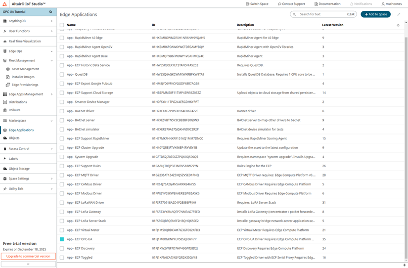

- From the left hand menu, click Marketplace.
Select App - ECP OPC-UA as the app to install. Click on
the box at the left of the name and click Add to Space,
positioned at the top right of the web page.
The OPC-UA Device Driver app is added to your space and a What's next pop up message is displayed.
Click to access the Edge Applications section.
You will see the App just installed, as in the following image:

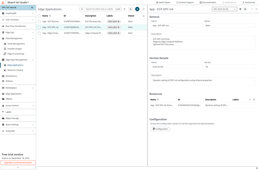

Select the OPC-UA Device Driver app from the list so the Details pane opens on
the right hand side. The latest version of the Edge Application is pre-selected.
Now click on the Configuration button at the bottom of
the pane to open the Configuration Settings pane.

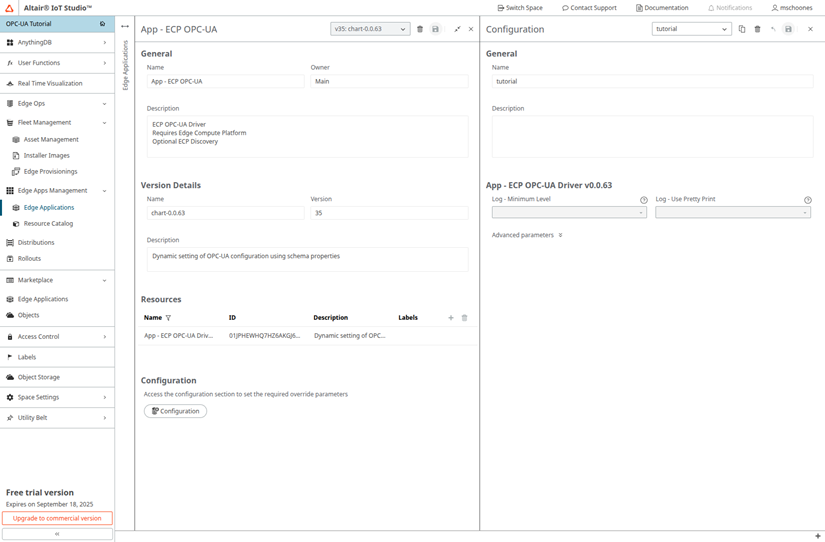

Figure 3.
- Enter the name and description of the configuration. This Edge Application does not require any other settings to be configured.
- Click Save.

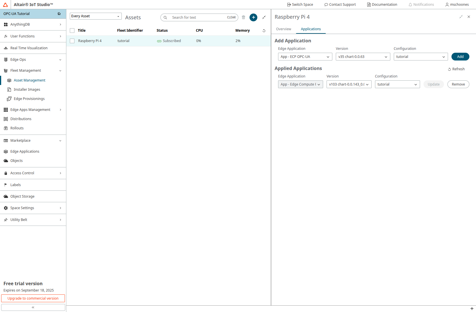

Install the newly configured Edge Application onto the Edge Asset as
follows:
- Go to the Fleet Management Asset Management section, choose your device (Raspberry Pi 4) and open the Applications tab.
- Select the Edge Application from the first drop-down menu.
- Select the version to use in the second drop-down, and then select the configuration you just created.
To add the app, click Add.
Figure 4.
