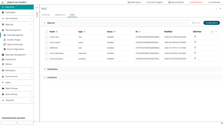

In the Rules tab you can manage macros, schedules, and listeners as defined on the edge asset. The application “App - ECP Support Rules” is required. See Marketplace > Edge Applications > Support Services > Rules for more information on how this application works. The Rules tab enables you to manage this functionality through a graphical user interface.
There are three sections on this tab:
  • Macros
  • Schedules
  • Listeners
The Macros section is expanded by default.
Figure 3.
Macros

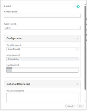

The Action macro requires a Thing to be selected as well as the action of the Thing. The optional input needs to match the input structure of the action on the Thing schema. For more information see the OpenAPI documentation.
Figure 4.

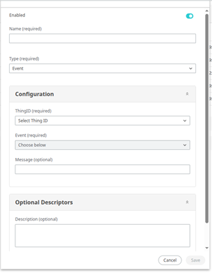

Event
The Event macro requires a Thing to be selected as well as the event of the Thing. An optional message can be added.
Figure 5.

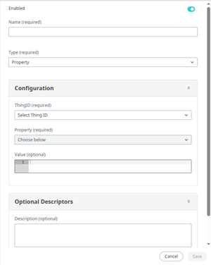

Property
The Property macro requires a Thing to be selected as well as the property of the Thing. The value of the property can use dynamic replacements based on the trigger data; fixed values can be set also. For more information see the OpenAPI documentation.
Figure 6.

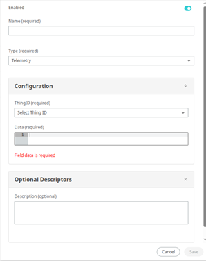

Telemetry
The Telemetry macro requires a Thing to be selected. The required data needs to be in the form of a JSON object to match how telemetry is published in our platform.
Figure 7.

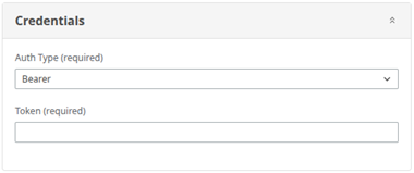

The REST macro can use a number of different authentication methods for the REST request:
Authentication Method Use When...
None No authentication is required.

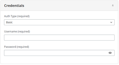

Basic Username and password are used for HTTP Basic authentication.
Bearer An existing bearer token can be used.

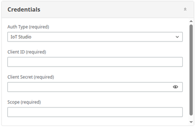

IoT Studio Use client credentials from the platform’s Access Control apps (this is also oAuth2):

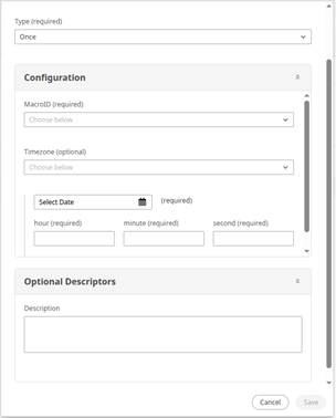

For the Once schedule, the date and time need to be configured. The timezone is optional (if omitted the app’s default will be used).
Figure 8.

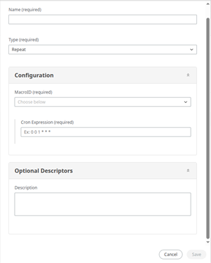

For Repeat schedule, a cron format is required (the 6-digit Quartz format is also accepted):
Figure 9.

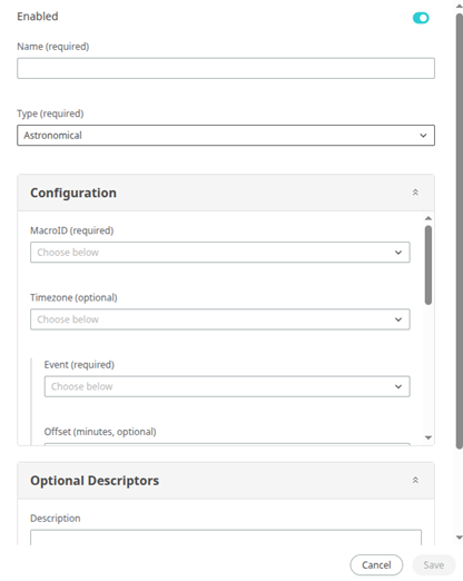

For Astronomical schedule, the event, the latitude, the longitude and either "every X day" or "day of week" are required.
The event is one of the following:
  • sunrise
  • sunset
  • moonrise
  • moonset
An optional offset in minutes can be specified (min -60, max 60).
An optional elevation (in meters) can be specified as well as an optional timezone. If no timezone is specified then the default timezone of the Rules service will be used.
If "every X day" (a positive integer) is specified, then the "start date" is required.
The "day of week" is specified as one or more days of the week.
Figure 10.

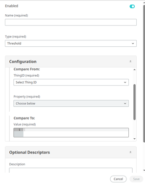

For the Threshold listener, the Compare From section needs to have a Thing and Property selected. The threshold value is entered in the Compare To section.
The required Conditional can be one of the following:
  • Equal
  • Not Equal
  • Greater Than
  • Greater Than or Equal
  • Less Than
  • Less Than or Equal
Figure 11.

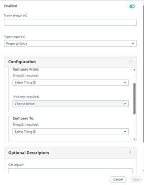

The Property Value listener uses a thing property in the Compare To section, instead of a threshold value:
Figure 12.

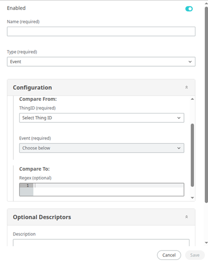

For the Event (Regex) listener, the Compare From section needs to have a Thing and Event selected. The Compare To section has an optional regex field that can be used to filter event messages that are allowed to trigger.
Figure 13.
