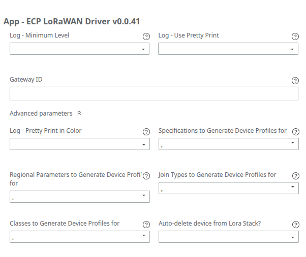

Auto-generate Placeholder Device Profiles
The driver can auto-generate device profiles at start-up. To do this, the following deployment configuration variables need to be set:
  • Specifications to Generate Device Profiles for
  • Regional Parameters to Generate Device Profiles for
  • Join Types to Generate Device Profiles for
  • Classes to Generate Device Profiles for
See previous section for an explanation of values to be used.
