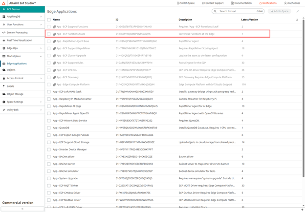

The functions stack can be deployed by adding the App > ECP Functions Stack application from the Marketplace to your own space (see Add an Edge App to Your Space).
The ase-support-functions service can be deployed by adding the "App - ECP Support Functions" application from the Marketplace to your own space.
