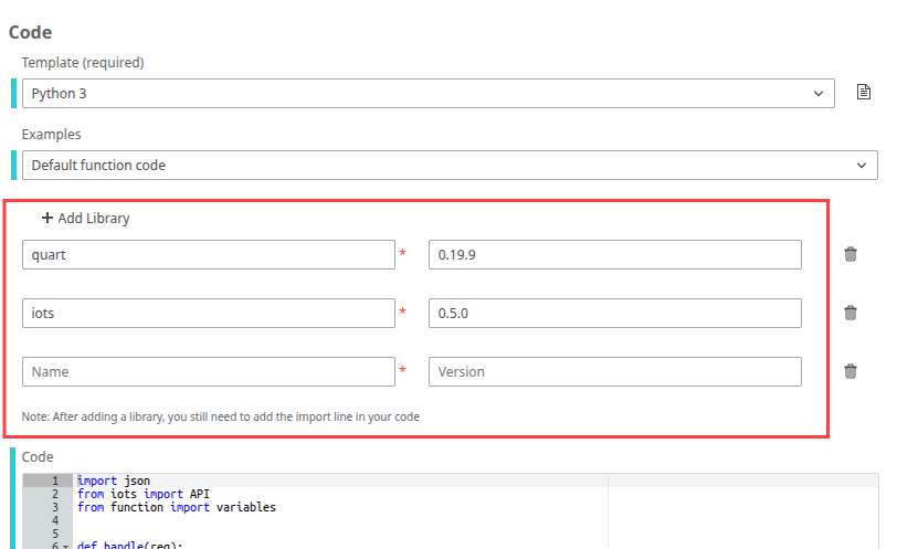

Libraries
Any library can be added to a Function for Python templates. To add a library, click on the + Add Library button and enter the name (required) and version (optional).
The only required library for Python template is quart.
The name of the library can be any in the recommended library list. For custom libraries:
  • name needs to be the same as the name of the package (for example, github.com/spf13/viper)
  • If a library is in the recommended library list, the name can be the alias (such as testify) or the full name (for example, github.com/stretchr/testify)
Non-required libraries can have any version. If version is omitted:
  • The predefined version will be used for recommended libraries.
  • For other libraries, the latest available version will be used.
The list of recommended libraries consists of:
