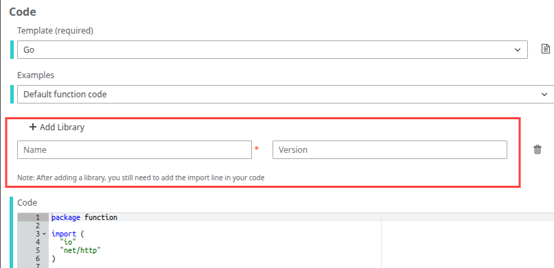

Any library can be added to a Function for Go templates. to add a library, click on the + Add Library button and fill in the name (required) and version (optional).
There are no required libraries.
The name of the library can be any in the recommended library list. For custom libraries:
  • name needs to be the same as the name of the package (for example, github.com/spf13/viper).
  • If a library is in the recommended library list, the name can be the alias (for example, testify) or the full name (such as github.com/stretchr/testify).
Non-required libraries can have any version. If version is omitted:
  • The predefined version will be used for recommended libraries.
  • For other libraries, the latest available version will be used.
The list of recommended libraries consists of:
