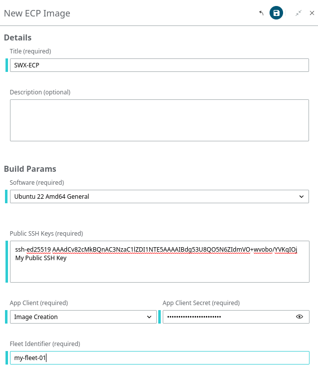

The installer image needs the Client ID and Client Secret of an App (see Apps) with the "cluster" scope and role Root as Policies. It is recommended to create a new App specifically for this purpose.
Follow the steps below to create a new installer image.
  1. From the menu on the left, click Edge Ops > Images.
  2. Click New ECP Image in the upper right corner.
  3. Select the desired software option from the drop-down menu, fill in the public SSh key(s) (each on a new line) for local access to the cluster (username: Altair) and add the Fleet identifier. If an existing Fleet identifier is reused any Asset flashed from this installer image will be added to that Fleet.
    Once the installer image has been created (this takes a few minutes) it will be available to download.
  4. Use either the pre-installed "disk imaging" utility on your computer or download balenaEtcher to flash the downloaded image onto a USB drive (minimum size 2GB).
    Note: The USB drive should now be used to boot the asset (gateway).
    When the installation process finishes the gateway will power off. An 8 character password for local SSH access is randomly generated and saved to the /root/crypt_passwords.txt file on the USB drive. This can be used in addition to the SSH key.
  5. Power on the gateway to bring the asset online in Altair IoT Studio.

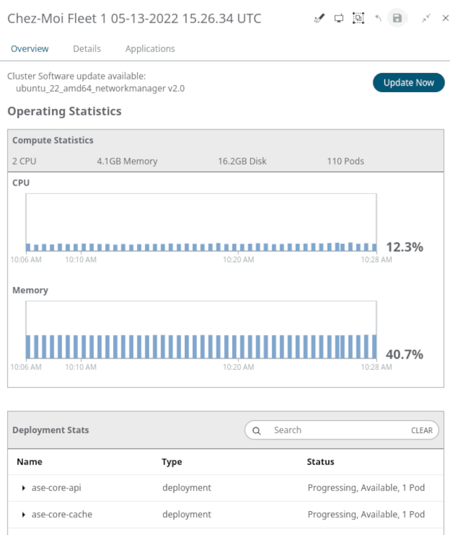

Software Update
When a software update becomes available for an Asset created from an installer image, it will be shown on the Edge Ops > Fleet Management > Asset Overview and Details panes.
Clicking the Update Now button will install the update. Note that this process can take up to 15 minutes for large OS updates.
