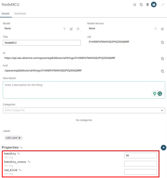

  4. Compile the code and upload it to your ESP8266 device.
  5. Check that the data was received in the Raw History tab, as shown below:
    Figure 3.
