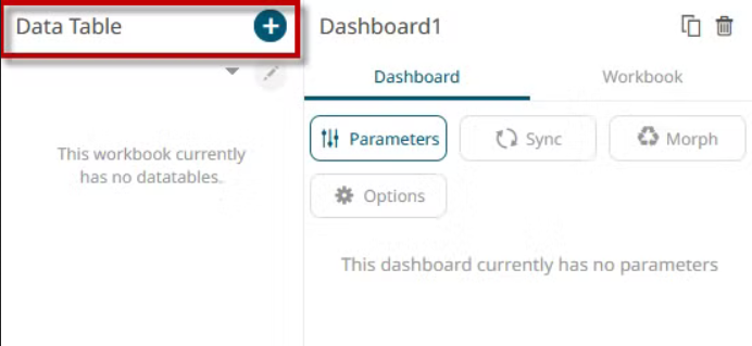

Create a Data Table by clicking the + icon.
Data tables define the queries and source data repository definitions, in
order to retrieve data. Figure 1. Data Table tab
