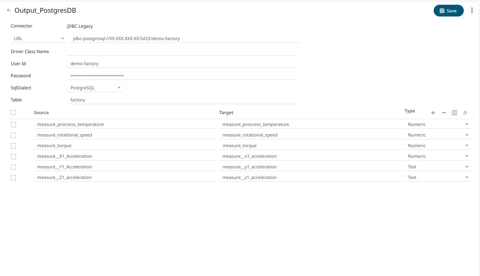

    The next step is to create another output data source to send the data to the influxDB
  13. Select +New Data Source.
  14. Enter a name for the new data source and click Create.
  15. Select the Connector dropdown.
  16. Select MQTT in the Output section of the dropdown list.
    Figure 4.
  17. Enter the following:
    • Broker URL: tcp://mqtt.swx.altairone.com:1883
    • Topic: spaces/{Your Space name}/categories/{Your category}/things/{ThingID}/properties
    • User Id: From the thing interfaces MQTT Username
    • Password: From the thing interfaces MQTT Password
    • Payload Template: {“variable_name": {variable}}
    The information related to the MQTT settings can be found here.
    Figure 5. Example of an output Data source parameters
