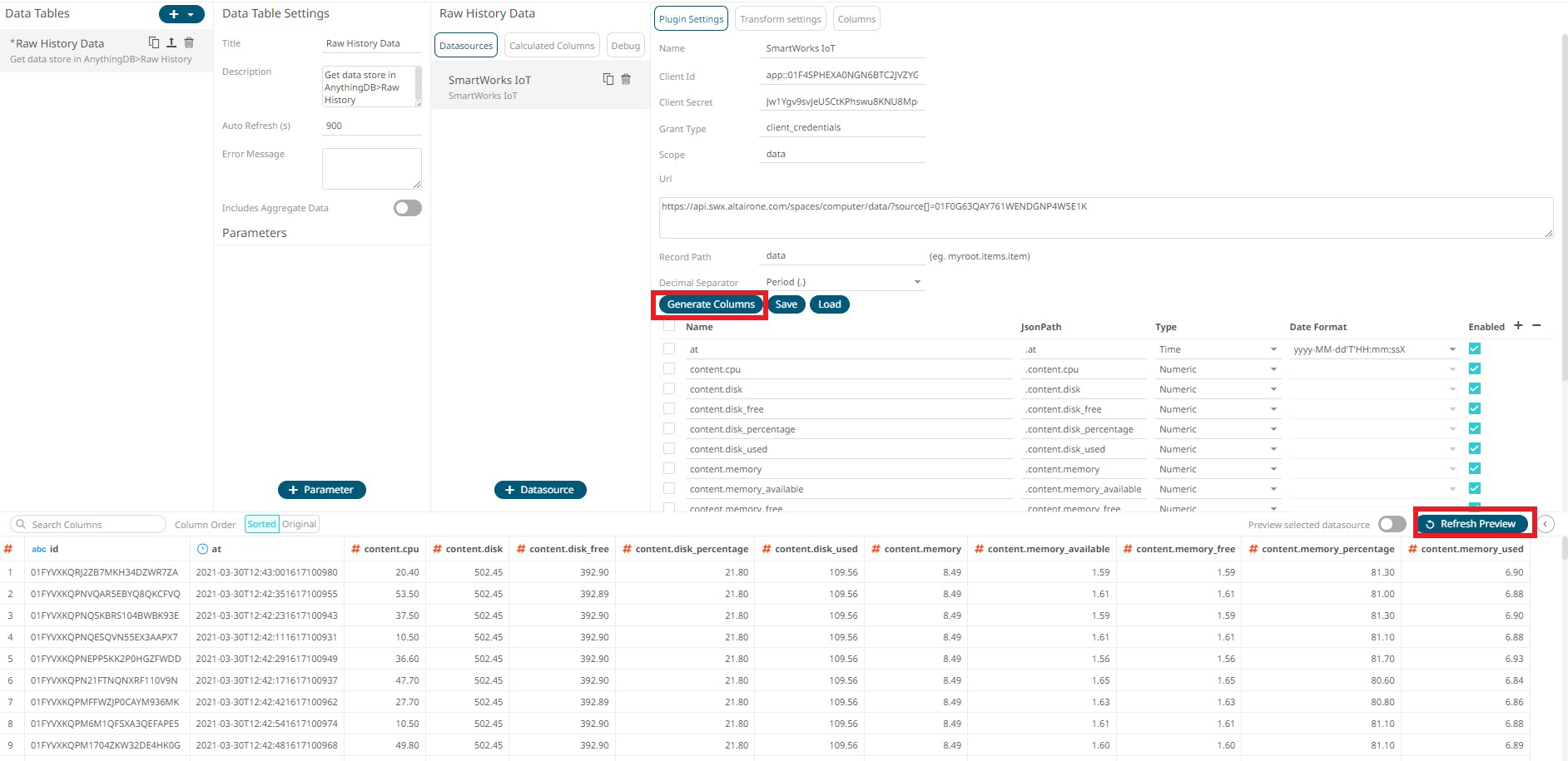

Create a Data Table by clicking the + icon.
Data tables define the queries and source data repository definitions, in
order to retrieve data. Figure 1. Data Table tab
Under Data Table Settings, enter a title and click the check mark to save it.
Enter a description, if desired.
Figure 2. Data Table tab settings
With Data Sources highlighted, under File/URL, select SmartWorks
IoT.
Figure 3. Data Table tab settings
Enter the following:
Client ID: from the App created in Step 1
Client Secret: from the App created in Step 1
Grant Type: type of App created in Step 1. Here we use
client_credentials.
Scope: from the App created. Choose Thing to
retrieve the Thing status of a Category, and
Data to retrieve the data stored at the Raw
History section.
